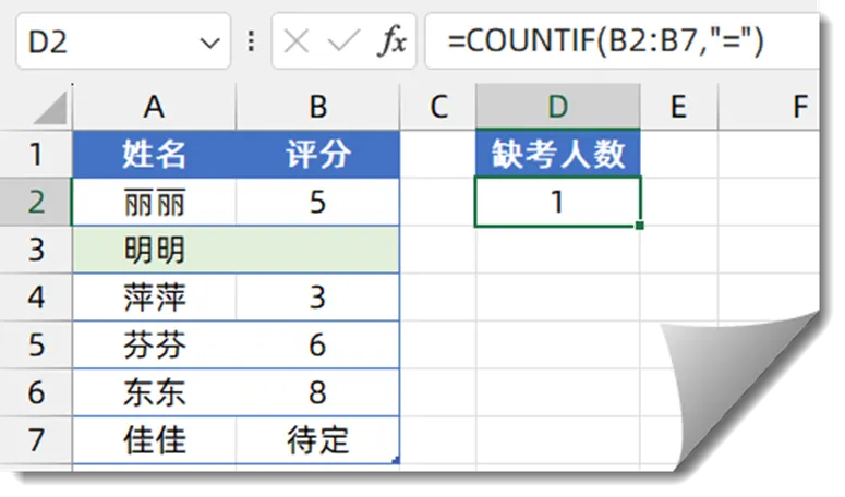

3、统计空白单元格数
=COUNTIF(B2:B10,"=")
