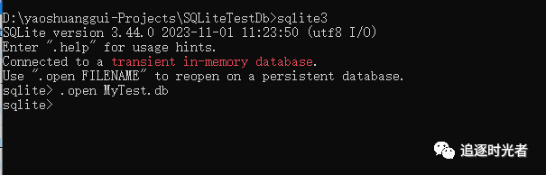

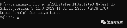

创建一个新的数据库文件:
在命令提示符下,输入以下命令来打开SQLite命令行:sqlite3
.open MyTest.db
建立或打开数据库文件:
sqlite3 MyTest.db

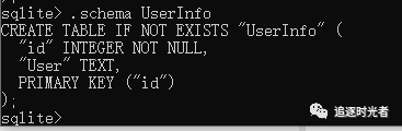

查看指定表的创建语句:
.schema UserInfo

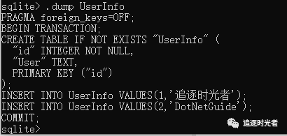

以SQL语句的形式列出表内容:
.dump UserInfo

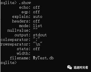

列出当前显示格式的配置:
.show

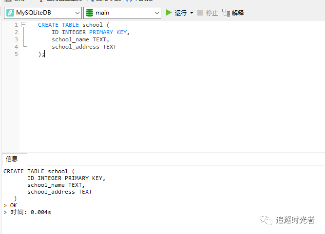

创建表:
CREATE TABLE school (
    ID INTEGER PRIMARY KEY,
    school_name TEXT,
    school_address TEXT

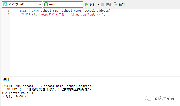

插入数据:
INSERT INTO school (ID, school_name, school_address)
VALUES (1'追逐时光者学校''北京市某区某街道');

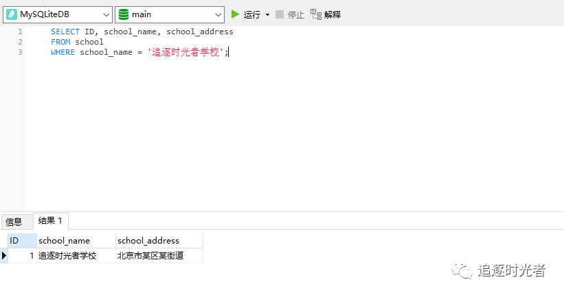

查询数据:
SELECT ID, school_name, school_address
FROM school
WHERE school_name = '追逐时光者学校';

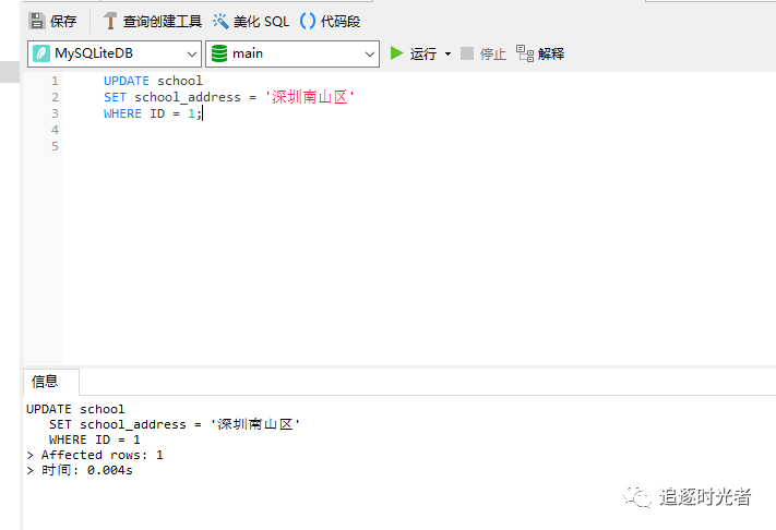

更新数据:
UPDATE school
SET school_address = '深圳南山区'
WHERE ID = 1;

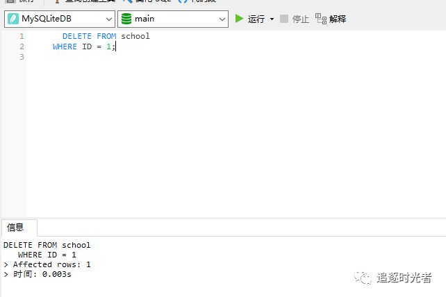

删除数据:
DELETE FROM school
WHERE ID = 1;

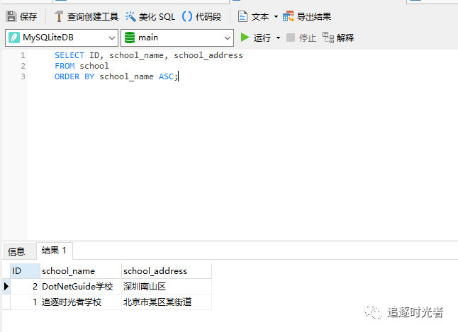

排序数据:
FROM school
ORDER BY school_name ASC;

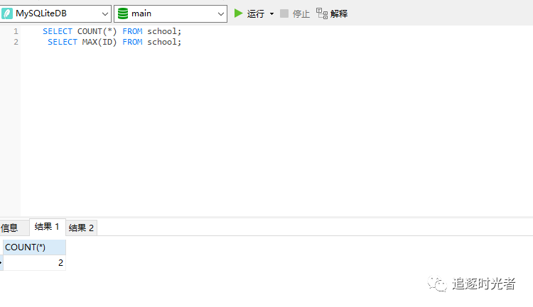

聚合函数:
SELECT COUNT(*) FROM school;
SELECT MAX(IDFROM school;
